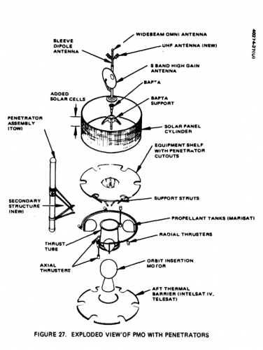

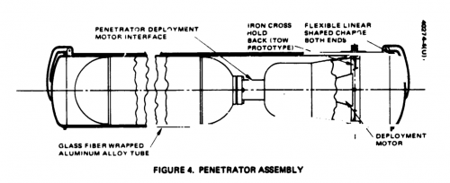

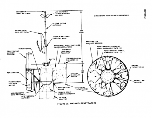

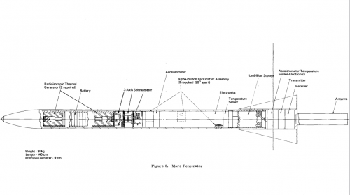

Concerned about the cost of Viking 1 & 2, NASA looked at lower cost alternatives for the 1977 & 1979 Mars launch opportunities . One of the proposed missions was to use a modified version of the Pioneer Venus Orbiter to carry six RTG powered penetrators to Mars.
Once the spacecraft entered Mars orbit the penetrators would be launched using engines modified from those used by TOW missiles. The orbiter would then act to relay the signals from the penetrators to Earth. At the time of the linked study it was thought unlikely that any science payload would be fitted to the orbiter itself due to the characteristics of the relay orbit.
1. Hughes - Pioneer Mars Surface Penetrator Mission: Mission Analysis & Orbiter Design
http://ntrs.nasa.gov/archive/nasa/casi.ntrs.nasa.gov/19740027142_1974027142.pdf
2. Sandia Laboratories - Mars Penetrator: Subsurface Science Mission
http://ntrs.nasa.gov/archive/nasa/casi.ntrs.nasa.gov/19750004806_1975004806.pdf
Penetrator missions are problematic. There's the problem of battery life, data relay, and the quality of the data. That's why they are rare.
I'll agree that they are problematic, but they seem to have given this one a long hard look.

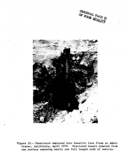

I've seen documentation discussing this idea for launch windows up until the early 1980's. I've attached a rather poor copy of a picture from a 1977 report by Ames Research Laboratory into the proposal of using the system for a 1981 launch.
http://ntrs.nasa.gov/archive/nasa/casi.ntrs.nasa.gov/19770025116_1977025116.pdf

Well that's the problem with Penetrator missions. You have to get the entry conditions right, or you run the risk of them hitting too hard or at the wrong angle. Given the 'decimal conversion problem' with the '99 Mars missions, it is quite likely (Though with the lack of telemetry impossible to prove), they were dropped off at the wrong altitude.
The PMO '79 on the other hand was intended to release it's penetrators from orbit, not while attempting re-entry, which would have reduced that risk. What the planners in '77 were worried about was the penetrator hitting a rock at the wrong angle and breaking open.

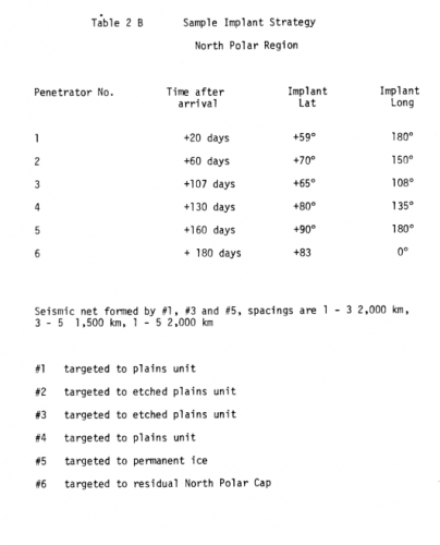

I've found a few more details on what was planned for PMO'79.
http://ntrs.nasa.gov/archive/nasa/casi.ntrs.nasa.gov/19930074311_1993074311.pdf
From that I've extracted the release schedule for the penetrators.
