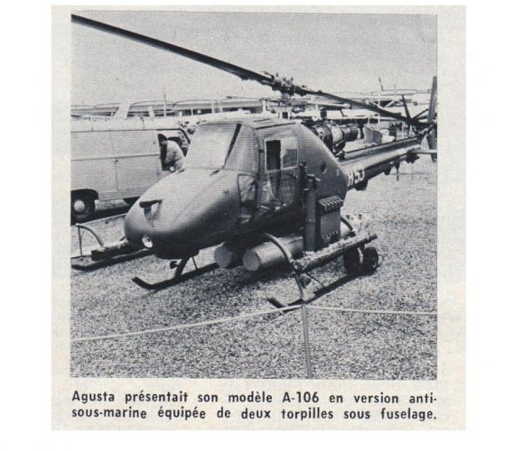

Terry (Caravellarella)
Dear Boys and Girls, here is another picture with a caption in French showing the Agusta A-106 prototype as exhibited at the 1967 Paris Salon......
The picture comes from the 15th June 1967 issue of Aviation Magazine International......

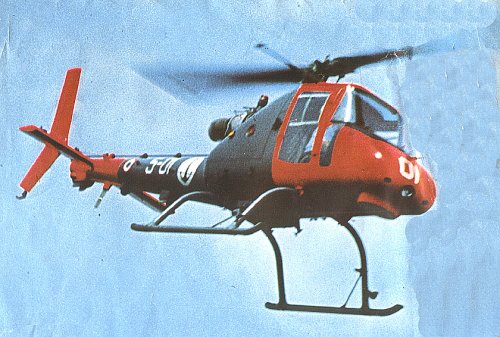

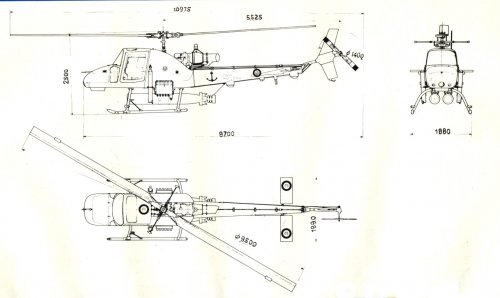

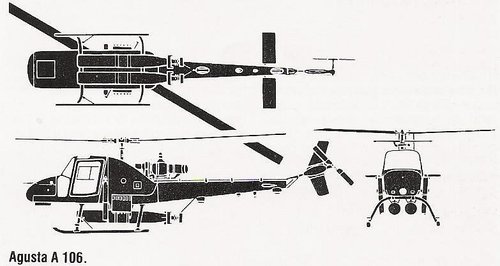

Hi girls and boys,
digging in a part of my archives that some years ago were damaged by floods, I found a photograph of the Agusta A.106 light shipborne ASW helicopter in flight and a three-view drawing of it.
This copter was designed as answer to a Marina Militare requirement asking for something like a manned edition of the Gyrodyne QH-50.
Two prototypes and five production aircraft were ordered but eventually only the two prototypes were built. Italian Navy evaluated exhaustively the two machines, nicknamed Schizzetto (Sprayer) but finally the program was discarded

I find sources online claiming that it had an "acoustic" submarine detection system, but the cockpit clearly does not have controls enough to use such a system. I found one drawing that might suggest some sort of sonobuoy or similar dispenser, possibly with the aircraft simply dropping the buoy with analysis sone aboard the mother ship. But I can't find any other evidence that this was a real thing. Jane's Fighting Ships from the era describes it as a "weapon delivery helicopter" (and lists it under the Impavado class description long after it was cancelled, hence the alternative nickname for JFS as "Jane's Frightening Slips.")
