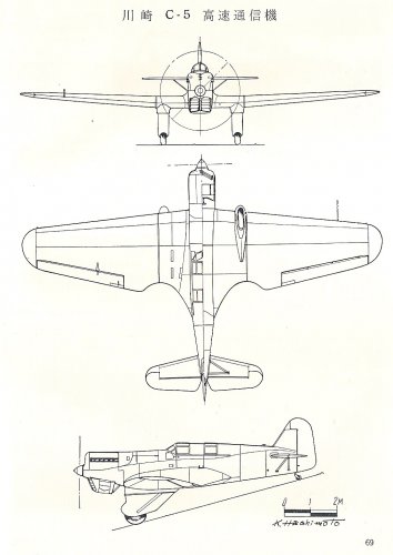

I am searching for more info of the Kawasaki C-6 transport with a retractable undercarriage,
( never built ) a development of the Kawasaki C-5 Communication Aircraft .Thanks in advange.
Swallow.
Source : Japanese Aircraft 1910-1941 ( Robert Mikesh & Shorzoe Abe ) Putnam.

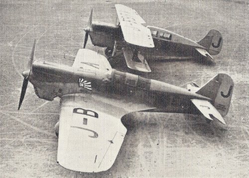

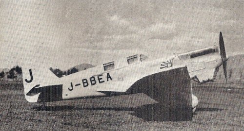

Hi! Kawasaki C-6 high speed transport plane did not leave from the drawing board. C-6 was designed based on Heinkel He70.
I can't find any drawing or picture of C-6. It's shape was similar to Heinkel He 70.
Span ; 13.4m, Length ; 9.88m, Height ; 3.045m, Wing area ; 30 square meter, Empty weight ; 1637kg, Gross weight ; 2850kg, Wing loading ; 95kg/square meter, Power loading ; 3.6 to 4.75kg/HP, Maximum speed ; 354km/h/S.L., 337km/h/3000m, 317km/h/5000m, Service ceiling ; 7500m, Range ; 2780km, Engine ; one BMW-8 liquid cooling V12, 800HP/take off, Pilot ; 1, Flight engineer ; 1, Passengers ; 4.
Attached drawing and pictures are KAWASAKI C-5.And Heinkel He70.
Source ; ENCYCLOPEDIA OF JAPANESE AIRCRAFT 1900 - 1945.sHUPPAN-KYODO PUBLICATIONS Tokoy, JAPAN

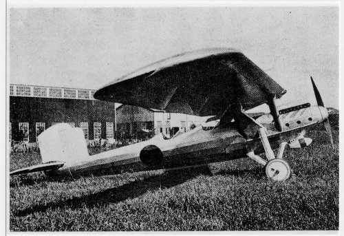

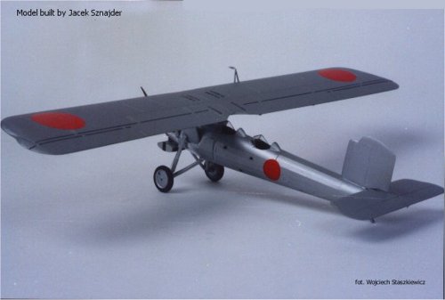

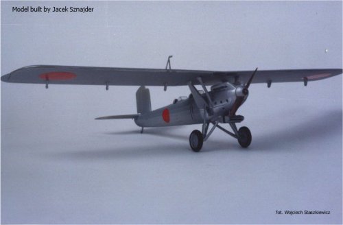

Hi Kawasaki experimental carrier reconnaissance plane.
The Experimental Carrier Reconnaissance plane
The IJN planned to manufacture the test prototype of the title of considering it as the material of research of all the metal airplanes, with the contribution of a coastal defense loyalty-and-courage meeting(Kaibo Giyu Kai,海防義勇会) in March, 1927.
And manufacture of one trial production airplane was ordered to Kawasaki Shipyard from the IJN.
This trial production airplane was a carrier reconnaissance plane, and the Hiroshi Sato assistant took charge of that design with the Junichiro Nagahata engineer.
Those days, the Junichiro Nagahata engineer was taking charge of the design of an airplane at the aviation research section of the IJN technical research center.
The design start was in March, 1927 and the completion of a design was in June, 1928.
Completion of the trial production airplane in the Kawasaki Shipyard airplane plant was in September, 1928.
The structures of this trial production airplane were all the metal structures where a new concept was added on the basis of a Dornier style.
The wing was a fabric cantilever parasol style single wing.
A wing had sweep back angle and the flap of large area was installed to the wing.
It was original for the carrier airplane which adopted the single wing and the efficient slotted flap.
A designer's intention was very progressive and was a memorable airplane in the history of aviation technology development.
However, since it was built and examined as the top secret, generally this airplane was seldom known.
Moreover, since the basic research about this airplane was insufficient, it did not develop as a practical use airplane.
Source : Internet, etc

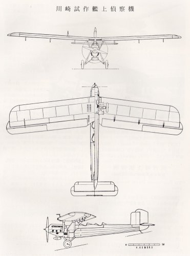

Hi! Please enjoy 3-side view of seldom known Kawasaki experimental carrier reconnaissance aircraft.
This airplane was made as an experiment in parallel to the third loyalty-and-courage number's flying boat, and the result was expected very much.
However, in the test flight in March, 1929, operation of the flap was difficult.
The test flight was carried out several times and stopped.
Probably, although this airplane was an airplane which equipped the world's first flap, it was very sorry about the test flight having been stopped, without being repaired.
Crew : 2, Engine : Mitsubishi Hispano-Suiza water cooling v shape 12 cylinders engine take off power 600hp, Span : 16.6m, Length : 10.65m, Height : 3.18m, Wing area : 43.7 square meter, Empty weight : 1200kg, Gross weight : 1800kg, wing loading : 41.2 kg/square meter, power loading : 4.0kg/hp, Maximum speed : 262km/h/S.L., minimum speed : 68.5km/h, Ceiling : 10000m, Endurance : 3 hours
Source : as usual

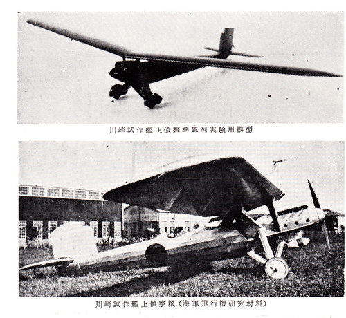

Hi!
Kawasaki experimental carrier reconnaissance aircraft wind tunnel test model, actual aircraft side view and front view.
Source : ENCYCLOPEDIA OF JAPANESE AIRCRAFT VOL.4
