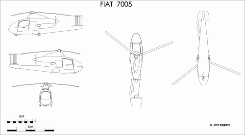

You're quite right, it remained a project. I quote from the vstol.org paper about Italian designs:
"Fiat, which had flown its 7002 reaction rotor helicopter in 1961, also had a design for a compound rotorcraft,
called the 7005. This work was also a result of the work Fiat had done with Sud Aviation in the design and
manufacture of transmission gears for the Super Frelon helicopter. As a result of this cooperation, Fiat started
to design its own high-speed helicopter. This three-seater used a streamlined fuselage and a pusher
propeller, blowing over a cascade of vanes at the rear of the fuselage for counter-torque and yaw vectoring.
Note that the vanes could vector 37º and the vane box could pivot a further 33º in order to vector the efflux
a total of 70º. The Allison 250 turboshaft engine powered both the three-blade main rotor and the four-blade
variable pitch propeller.The 7005 fuselage was 7.92 m. Rotor diameter was 8.4 m and the propeller was 1.2 m.
Total height was 2.6 m. The landing gear retracted into blisters to minimize drag."

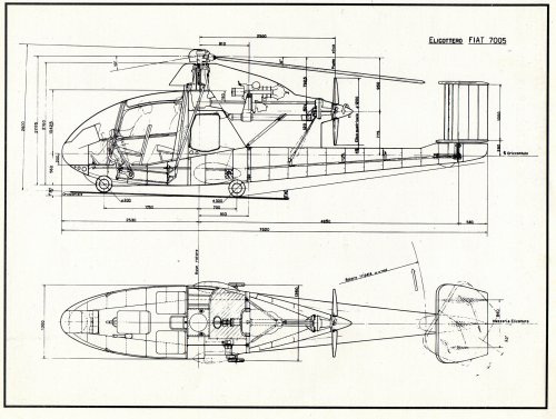

...about FIAT Aviazione 7005 project, I found a couple of more detailed section views (dated 1965) I enclose
Nico
