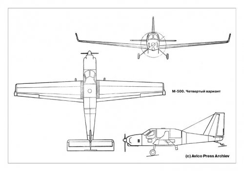

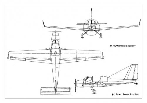

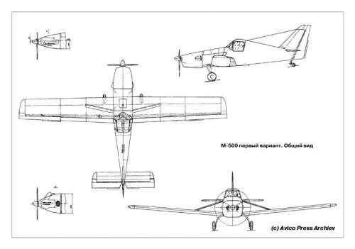

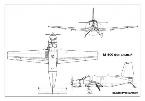

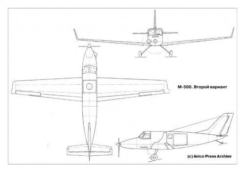

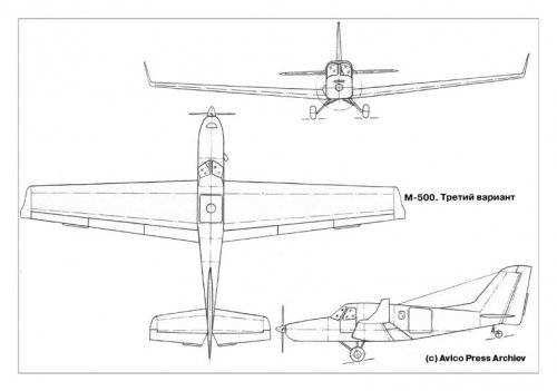

MDB has also done some agrycultural prijects - M-15, M-101SKH. M-206, M-500
Here are all variants of M-500

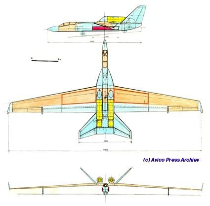

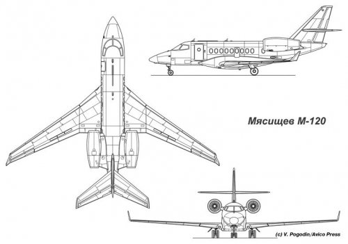

Many thanks Ucon for the M-120 view.
Excellent!

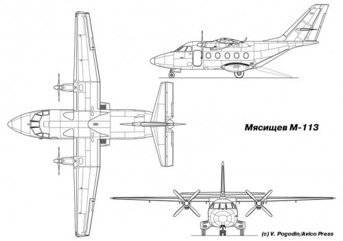

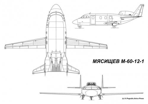

M-60 - large family of aircraft, which includes biz-jets, medium and long range aircraft, cargo/transport, wide types of military planes - strategic bombers, recon, FHQ, supermission variants etc.
Here is small biz-jet.

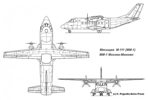

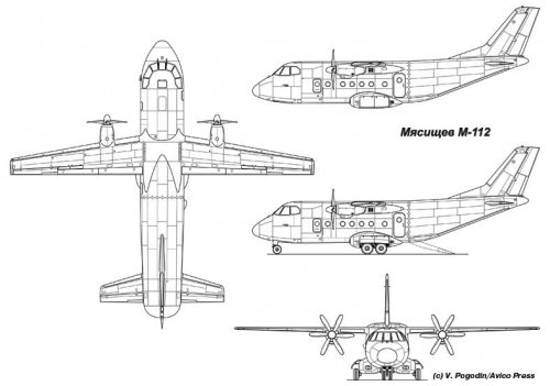

[*]M-111 and M-112 : Which was the MM-1? I always figured it was the M-112, but from what you posted it seems it was the M-111 instead... Or were the two projects part of the MM-1 effort?

Of Course, BOR-4, BOR-5, Buran etc. were the great part of the EMZ design history. It was detailed described in 8 volume of Myasishchev Encyclopedia
