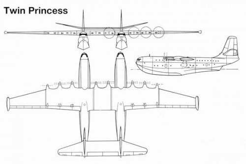

And the Princess Twin is also well known, not only by Tophe, I think ... ;)

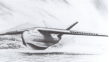

Saunders-Roe marine airliner project
the Saunders-Roe's chief designer,Mr. Henry Knowler designed a very beautiful
marine airliner aircraft,notice the engines was mounted at the rear wing and
it had three decks.

Re: Saunders-Roe marine airliner project
This was not a projected design but a visualisation of what could be
in he future.Some sources mentioned it as nuclear powered...
Not unlike the Duchess, though.
The Duchess, I think, was smaller, this one looks like the category of the P.192,
which would have been powered by 24 RR onways or 16 Bristol BE.25 turbo-props.

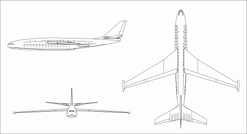

The designation of the tandem wing flying boat is
Blackburn B-49B....
In the latest Aeroplane Monthly issue, featuring an article about the SR.45 Princess,
this design/concept or whatever we would call it, is shown again with the same picture,
described as a 6-engined flying boat, "..taking the idea of jet powered flying boat another step
beyond the Duchess.". So, not more, than an artist impression, probably (and that
may explain, why it isn't shown in Tagg/Wheeler "From Sea To Air"), but a really
beautiful one. ;)

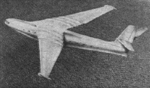

Saro P.192
Saunders Roe designed and built the Saro Princess flying boat. Though it was an excellent machine, only two were built, as there was little need for flying boats after the War. None of this, however, deterred the company's designers from conceiving an even larger jet-powered version, powered by no fewer than 24 turbojets buried in the wing! Source: Jerram, M. Incredible Flying Machines: An Anthology of Eccentric Aircraft. (London, Talos Publishing, 1980)
http://rides.webshots.com/photo/2695001730048918155QVwPHU
EDIT: Jemiba has identified this design as the P.192 and not the "Jet Princess" as it was identified from the web site I found the image. Post updated and artwork filename renamed.

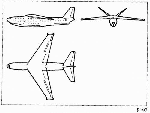

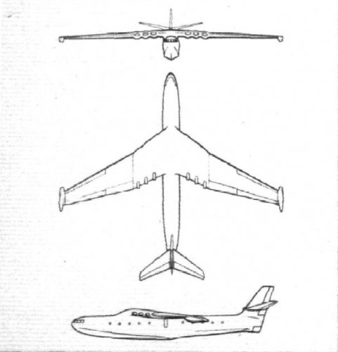

It's the P.192, which should have had a weight of about 1,500,000 lb, a span
of 313 ft and be able to carry up to 1000 passengers !
Sketch and artist impression from Tagg/Wheeler "From Sea To Air"

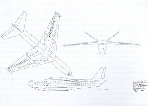

The 3-view of the Saunders Roe 'Duchess' in Flight Global (4 May 1950) is perhaps the 'best of a bad bunch'. Any body have a good quality copy of that same drawing or a better one? It was such an attractive design, but the 3-views I have seen do not do it justice.
SR.45+6xcoupled RR Tweed was funded May,1946 intended as 3 for BSAAC and in an MR variant. It settled as Princess/4xcoupled, plus 2xsingle Proteus; 4 more were ordered by Govt. for BOAC in 1948, when Spec. R.2/48 was put out to tender, for >80 for RAF, won by Saro P.162/turboprops. Meekcoms/Morgan, Br. A/c Specs File, Air Britain,1994 has P.162 work continuing to 1955. BOAC had ceased Shortly splashing on 10/11/50 and told their owner they had no use for 7 Princesses; when cancelled in May,1954 Govt. understated the nugatory expense as "work would continue for RAF" (i.e: on P.162). Fabrication would have involved Vickers-Armstrongs, who kept Saro active on Valiant noses and Viscount 700 wings. 1950 "Duchess" was doodled awhile unfunded, alongside 1951 MoS studies of mixed-powerplant interceptors. P.162 lapsed and SR.53 was funded Sept.1955 (inc.$1.5Mn. from US MWDP) as proof-of-concept for (to be) SR177. Vickers lost interest in Saro; in Sept.1956 DH, to embed its Spectre/Gyron Jr., bought 33%, intending to build SR177 at Christchurch/Hurn. When that died in Dec.1957 Saro was left with modest rocketry and ex-Cierva, taken on by Westland, 14/7/59.
Re better 3 views - stashed away in my 'heap' I have a copy of the brochure and a set of high quality scans for
Duchess 1 and 2. May take a few days but will try and dig them out for you / all to see.
Cheers
Fred
