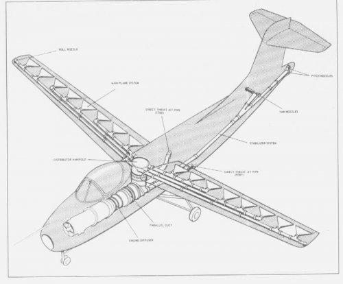

The H.126 by the way had two "direct thrust jet pipes" (see cut away from Aeroplane Monthly
January 1995). As far as I can tell from the side view of the Avro 746, the wing had a much lower
aspect ratio, than the Hunting design. Together with the retractable landing gear, maybe it was
an attempt, more aimed at exploring the practical use of jet flaps, than just doing basic research
of the principle ?
