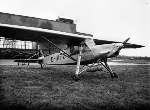

I was reading "Aircraft in profile" Vol 11 at a local library. there is an article by Richard P. Bateson on the Storch, and there is a one paragraph description of a Fi-156 modified in 1940-41 by Ing. Woeckner of A.V.A. (is that some sort of Akaflieg?) in Goettingen. the aircraft was designated AF-2, it had an uprated AS 10H, 275-hp engine driving a blower in the fuselage that supplied air to a new set of wings devoid of tanks, gas supply being carried in an external tankunder thye fuselage. Most of the fuselage and empennage was stock. Apparently the lift coefficient went up from a very healthy 1.9 to a remarkable 3.8. Does anyone have pictures or specs?
Yes, I have data from captured WWII German document (NASM microfilms). Unfortunately, it is not accessible right now. However, my memory is it was fairly detailed with drawings and photos.

NACA translation of a war time German report on the AF-2
https://ntrs.nasa.gov/archive/nasa/casi.ntrs.nasa.gov/19910073056.pdf
nice drawing and photo of the AF2 via DLR
drawing cleaned up and straightened a bit
sources:
http://www.dlr.de/100Jahre/desktopdefault.aspx/tabid-3299/5148_read-7459/
http://www.dlr.de/100Jahre/desktopdefault.aspx/tabid-3303/5152_read-7463/
