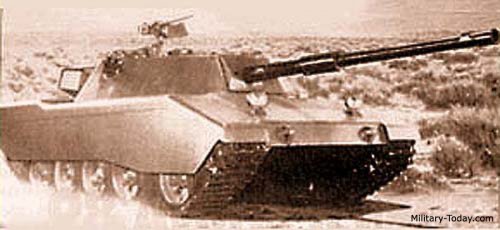

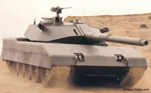

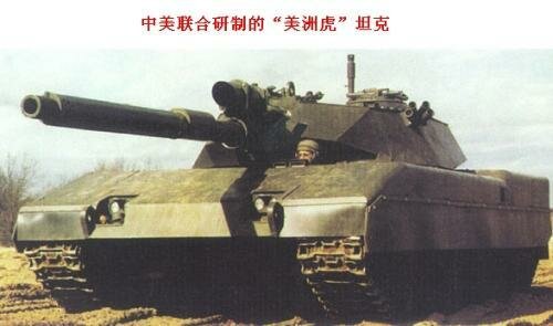

The Jaguar was a joint Chinese/US project between Cadillac Gage and the China National Machinery & Equipment Import & Export Corporation with the intent of modernizing the Type 59 tank and its variants in the mid-1980s. The political fallout of the Tiananmen Square Massacre forced the US and Chinese teams to part company in 1989. Cadillac Gage continued development of the Jaguar on its own, but there was no market for the tank since it was glutted with used tanks after the Cold War.

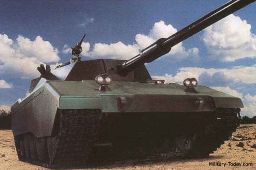

Always liked the external appearance of the Jaguar.
Biggest question(s) that come to my mind being:
if it's an evolution of the T-55/Type 59,
was it their basic hull and turret with the added applique armor,
or a completely new turret design altogether,
and/or a modified hull interior?
(it obviously had the better western engine...)
If it did use the original hull and turret configuration, with just the "western armor" added on giving it the appearance of a more modern tank,
my guess then is it would still be as cramped inside as the T-55/Type 59, and wouldn't really fight much better, despite looking more advanced.
(poor ergonomics can't wholly be overcome with better guns, sights/fire control, suspension, etc...)
Anybody?

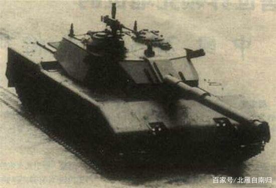

As I understand it, the turret was all-new. In fact, so was the top deck of the hull, the engine, the transmission, and a sizable portion of the running gear. There wasn't a whole lot left of the donor Type 59 except the lower hull, the suspension, and maybe the driver's station.
seems like they took what they had learned with the frontal armour of M1A1's and deflection points. they did well!
