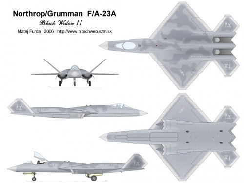

thanks for the 3-view, very interesting...

Remarks to Mato -
a). In a plan view, all intake edge lines are straight, no these curved outer lips.
b). F-23A would have the same nozzles with top covergent/divergent flaps, as YF-, just trenches' tiles would be changed in favor of more light, flexible insulation pattern, and configuration of serrated boattail in planview would be changed to improve weight, IR and stealth characteristics (later shown right).
I still try to figurate the new shape of the engines fairings.
Did they were make come closer to each other?
How their size was reduced? including in height?
It seems from Matej and koku fan drawing that the aft part of the fuselage on the upperwing was lenghtened, right?
You can easily compare both variants overlaying each other in any CAD program (as sizes are known). In common, you are right.

two questions for Matej:
1) Why use zigzag wing on backside
You should have known the dentate wing edge would destroy a capability of low detection from radar
2) Why use 3 dimentions shockwave half cone airintake?
The cone specially for this half cone airintake will cause an unsymmetrical air flow while the aircraft do any high attacking angle of maneuver.

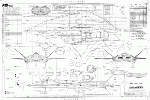

Ca. 1991 Koku-Fan has published 3-view of EMD F-23A, Matej drawings based on this illustration. Dimensions (lenght, for example) and overall shape was pretty different from then already released YF-23 drawings and overall dimensions. Text capture mentioned that there were drawings, showing, among other details, additional internal bay for AIM-9s, occasionally distributed (and immidiately returned back) to the press representatives during YF-23 roll-out ceremony, fact, confirmed at least by one other independent source (Flight International, AFAIK). Other insider source also confirmed that these drawings are very close to CAD printouts of EMD F-23 that he has seen, including 'B-2 style' inlets with serrated cowls. Dogtooth at the leading edge is strange to mee too, I never seen such an aerodynamic/stealth arrangement. I can suppose that vortices produced by them can interference with -23 giant V-tails to improve stability at high AOA, that was a problem of this ATF competitor, but it's just speculated guess.
1. I think (like the flateric) that the tooth was placed there because it can create an additional vortices. And regarding to stealth, it is the matter of the shape, materials and size, not if something is zigzag or not.
2. This type of cone is simply much easier and less expensive than original porous used on YF-23 prototype. People in Northrop found that its not necessary to always remove boundary layer from the inlet and the cone can be integral part of the fuselage without gap between. This is exactly what is now applied on F-35.

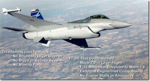

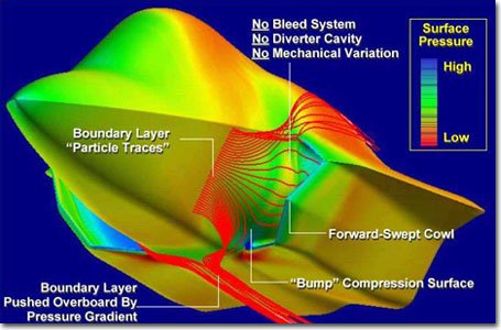

Well, as was demonstrated on the JIST testbed, there are other ways to remove the boundary layer than using splitter plates. This has been incorporated on the X-35 and now the F-35 and I assume Northrop would use the same approach on any FB-23 proposal. I've heard that the final F-23 proposal dropped the sawtooth inlets as unncessary, but I couldn't verify this.
Actually, that's a mis-interpretation. It is important to remove or 'move' the boundary layer before the inlet, there are just different ways to do it. The bump before/in the inlet serves to cause the pressure distribution in front of the inlet to push the boundary layer around it. At least that is what has been reported in some of my aviation magazines. Also, they probably use porous materials in the inlet to suck the boundary layer away, as was done on the YF-23 prototypes inlet; That's the dark "patch" you see under the wing in front of the inlet on the YF-23.

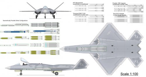

Some alternative weapon configurations made from my drawing by Nikolay Andreev. I just forgot to remove the scale - image is sized down to be able to post it here.

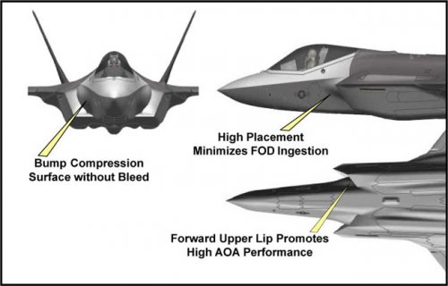

In all the comparative flight test data I saw (and I was at Northrop at the time), the YF-23 consistently outperformed the YF-22, could carry as much, and the production proposal had a more flexible, in terms of carriage, internal weapons bay set up with the builkhead between the two bays capable of shifting fore and aft like the bulkhead between weapons bays 1 & 2 on the B-1B. Where the F-23 proposal fell down, majorly, was on the management side; the USAF not having tremendous faith at that point in Northrop's ability to manage the program. This is the information that was conveyed to the engineers after the post-award de-brief by the USAF.
Oh, the extensive sawtooth shown isn't necessary (take a look at the F-35's inlet, or that flown on the JIST testbed to prove out the theory behind it. The YF-23 didn't need vectoring nozzles, it already was as maneuverable as the YF-22 and the nozzles just add complexity and weight.
RE: the sawtooth thing, maybe we're getting tangled up in terms. Though the F-35 inlet doesn't exhibit rows of small saw-teeth the whole thing is a three angled-edged 'tooth' (it's definitely not square so what's a better term?) and the design features many more on its panel and door edges.

Having said that, a F-23 with inlets shaped like the JIST inlet would work nicely.
Do you have any images/diagrams/links of the JIST intake tests? (I can only find committee reports) It would be great to update my virtual aircraft catalog without the need for so may jaggies.

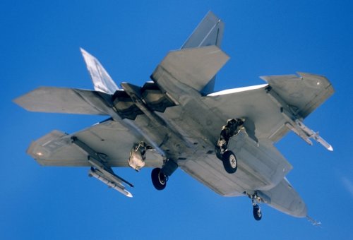

The image below shows one way to increase the missile load of a stealth plane - and they've got another pair of pylons they could use! ;D
Cheers, Woody
If you have text, here are the pics: http://www.hitechweb.genezis.eu/fightersAP07.htm

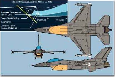

Well, if you go about 60% of the way down the page, he's got some excellent pictures of the JIST F-16 inlet. I've seen better, but those were part of my introductory briefing on the F-35 and I'm not sure how widely I'm allowed to distribute those.
Thanks Elmayerle/Matej,
For some reason the pictures don't load on that page of Mataj's site when I use Firefox (maybe they don't for other people either). I just tried Explorer and it works fine.
I've seen this F-16 before but the smaller images of the inlet disassembled are very revealing as they don't appear to show any suction device for boundary layer removal though there is an interesting recess right at the front of the 'hump' which is covered when assembled. Do you know what this is for? The images in-flight look potentially retouched just around the intake area to this photochopper's eye, maybe to hide that secret bit?. And that chin spike is for aerodynamics only you say.

Ahh, now I know why Matej's site nevered shows pictures...
more on DSI/F-35 inlets

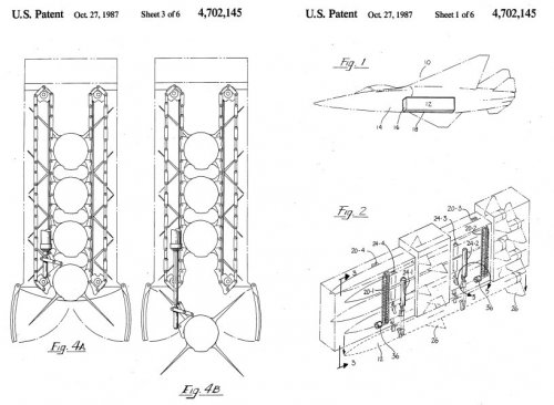

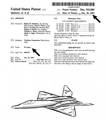

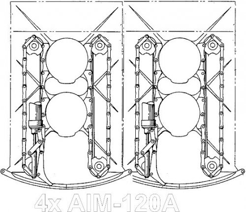

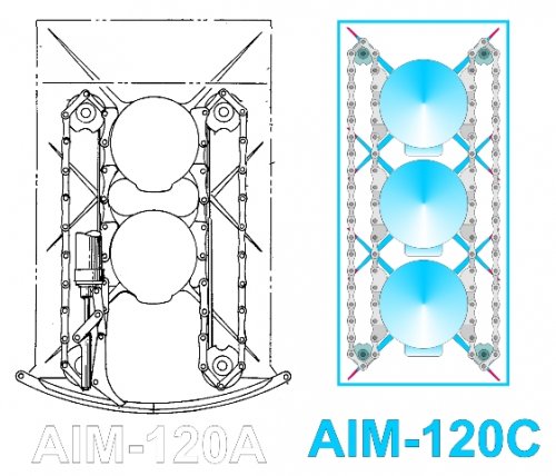

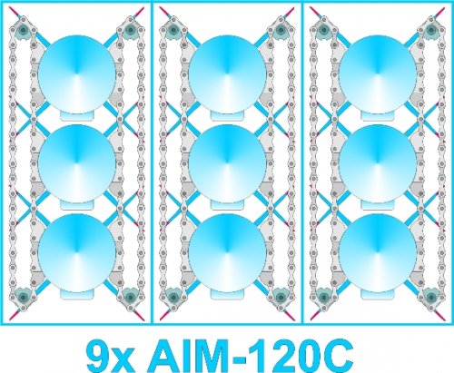

Ever since I run across the Northrop Patent in Reply #28, some 3 years ago I was fascinated by the ingenuity of the design and the potential that it has.
1st. Its amazing how little space can 4 AIM-120A can take. You can never fit 4 like that on external stores. And some people thought that internal bays for aircraft meant less space for weapons. Only they forgot that internally carried weapons do not need forward launch clearance zone and can be placed much closer to each other.
2nd. lets analyze the launcher weight. We have a common launch mechanism and we have a common holding mechanism. Compare that to the weight of 4 externally carried pylons for all 4 AMRAAMs.
3rd. The potential it has when considering the AIM-120C with the clipped wings. If we look at the launcher as it is now we see that the wings of the bottom missile determine its proximity to the launch door in the same way the wings of the top missile determine the height of the mechanism. Similarly the wings on all missiles make the width of the whole launcher. Lastly the distance between the missiles are also limited by the wings. See a pattern. What if we are to clip those wings like on the AIM-120C variant?
If we are to design the whole mechanism around the AIM-120C, it will be 22% shorter and 35% narrower. In other words, you can say that 3 of the new launchers will fit on the place of 2 of the old ones. The F-23 weapons bay is almost as tall as it is wide as seen on the declassified video footage. If it were designed to carry 2 of those launchers with 2 AIM-120A each (the minimum), it can easily be modified to carry 3 with 3 AIM-120C each. That’s 9 total.
However this concept has its critics which say: A jam in one of the missiles will render the other above it useless. This is funny to me as missile launchers are hell of a lot less complex than engines yet some fighters have single engines. And the Lockheed 1985 wining ATF proposal had a revolving launcher. If it failed all the missiles might fail to launch save only one!

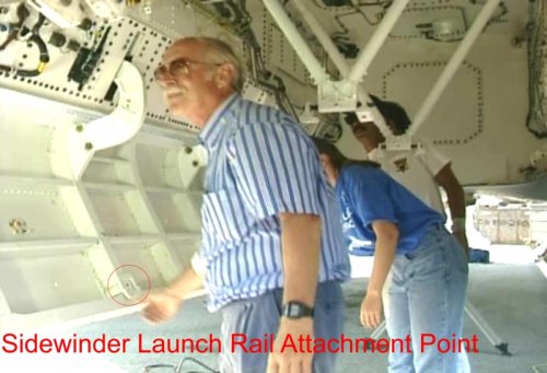

Looking at bays for the short range missiles, the F-22 has 1 for each Sidewinder missile. A sidewinder must be a dams important weapon for the ATF to have is own weapons bay. :-\ . Fitting two missiles is a lot more difficult as they have to be extended sideways and the wings cannot overlap. :( At least Lockheed designed it for access panel for other things too.
The F-23A had a dedicated short missile weapons bay. It can also carry a total 2 Sidewinder missiles. Converting it to carry 3 missiles (AIM-9X or ASRAAM) could be as each as the F-22 conversion from 2 A models to 3 C models of AMRAAM in its each main missile bay.
All in the F-23A with a slight change in the launchers could carry 4 more missiles or 50% more than the F-22A
A pics of all that will come shortly
Here
