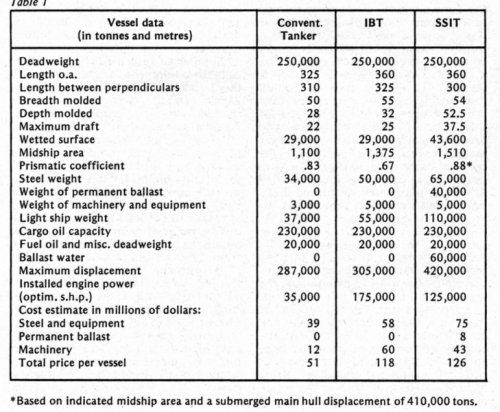

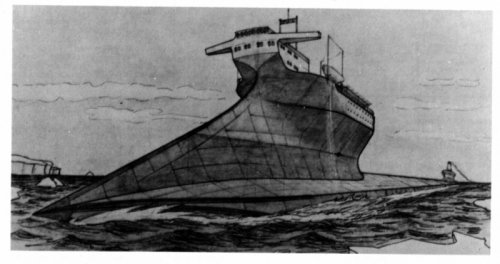

During 1970/71, the Norvegian Aker Group studied concepts for an icebreaking tanker with the capability of year round operation under Artic conditions. Three concepts were considered: a conventional hull icebreaker (IBT) and a couple of semi-sumersible concepts (SSIT).
Source: Aviation & Marine magazine April 1976 issue.

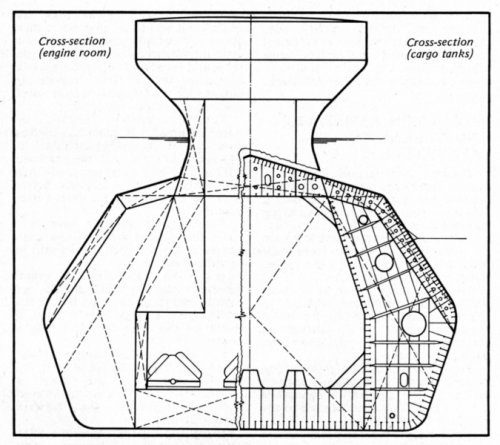

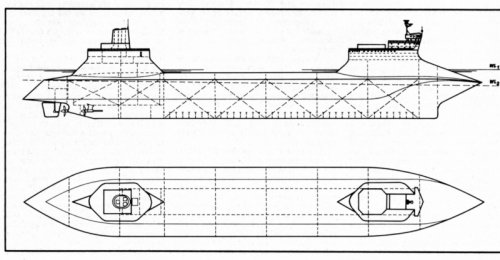

SSIT selected project
