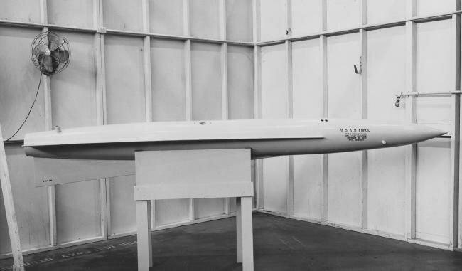

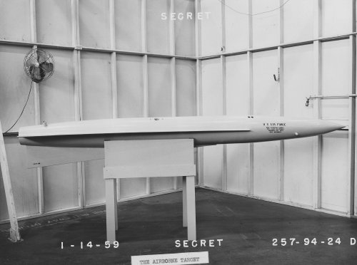

The Airborne Target missile.
Would have been carried in the internal weapons bay and launched to provide Mach 3+ targets with possibly programmed evasive manouvers to help train F-108 pilots in using their Radar/GAR-9s against Mach 3+ targets.

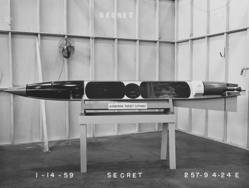

Okay, yes a decoy could be a thing. Seems odd for an interceptor to carry a decoy, so I suspect this was for the Penetrating Fighter mission.
Dubious. The unrefueled combat radius of the F-108 was only a bit over a thousand miles. Not going to be doing much penetrating with that performance.
The drone is described only as an "airborne target for the F-108." This likely means that it was to be used as a training aid for the F-108... carried and launched by *something* *else,* shot out of the sky by an F-108/AIM-47 at great range. The drone would presumably have an RCS designed to look like a supersonic Soviet bomber.
this image of the XQ-11 was posted on @Andreas Parsch website. I wonder if there were mutiple bidders? Is this the Radioplane RP-91 or something else?
The XQ-10 was a Radioplane, and the XQ-6 was WADC/Radioplane, but to the best of my knowledge, the XQ-11 did not involve Radioplane; in my list, the XQ-11 is solely a WADC design. Radioplane did submit a proposal for the F-108 program, but it doesn't mean it was accepted and/or was given a designation. But I'm willing to be proven wrong, by all means!
Given the kinematic needs of an airborne target for a mach-3 interceptor, it makes sense for the target to be launched from another mach-3 interceptor.
This reconciles the “carried by the F-108” and “108 airborne target” quandry.
Also this picture from RyanC's post.
f-108-airborne-target-cutaway-jpg.84342
Cheers - moved Ryan's post to this topic.
