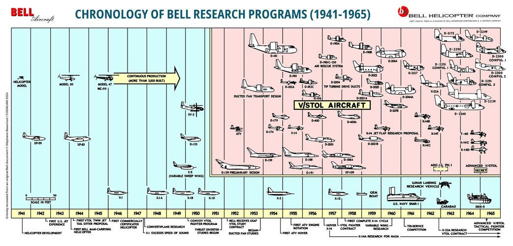

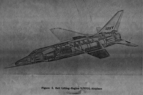

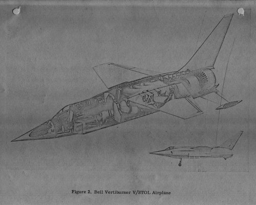

Does anyone have better versions of the following D-188A precursors? (Sorry about the orientation of the first one - my Mac conspires to revert to the original orientation of the scan in some cases even though it's depicted correctly in the file.)

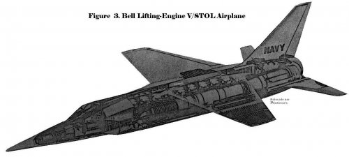

Why... yes. Since APR issue V2N3 will have part one of the D-188 article, I happen to have these to hand. The full-rez images (and many more) will appear in that issue.
The "Vertiburner" was probably the D-139. I've seen conflicting reports of the configuration of the D-188.
The Vertiburner system on the D-139 appears to have turned out to have been about as successful as the augmentor wing on the XFV-12 or the augmented thrust on the original XV-4 Hummingbird. Consequently, Bell took the basic design back to the board, yanked out the Vertiburner and repalced it with dedicated conventional lift jets and called it the D-188. How they got from the D-188 to the D-188A, I've no idea.

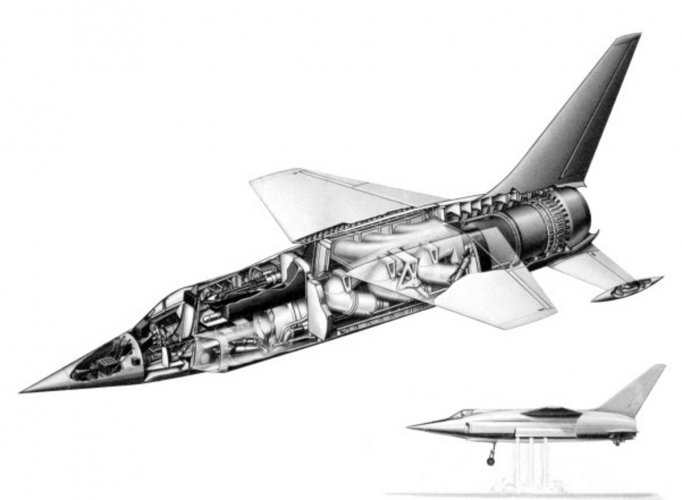

I'd sure love to see more on the D-2001 and the D-2021B. Look to be either research planes, or ground attackers. But this is all I have.
From the Bell Museum

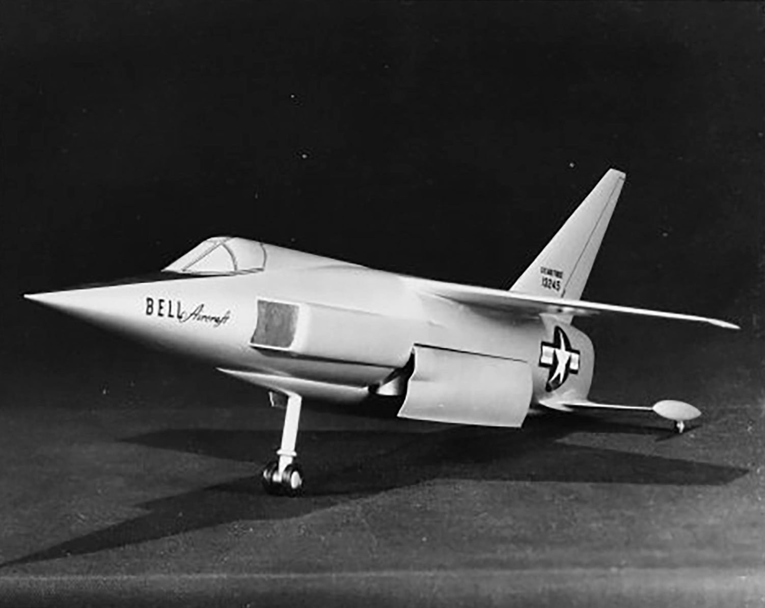

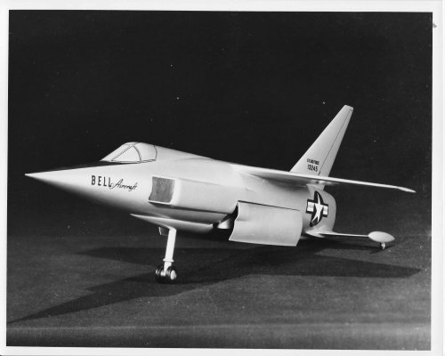

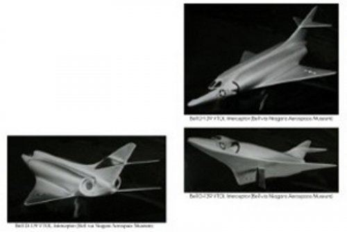

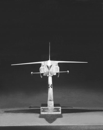

Bell D,139 project
Any information, or drawing of this project?
Nice design but only small pictures, maybe 3 view?
Simply aerodynamic line, but superb performance

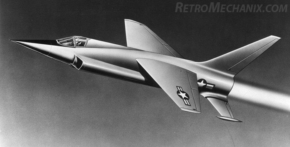

Retouched...!

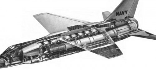

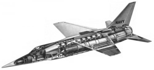

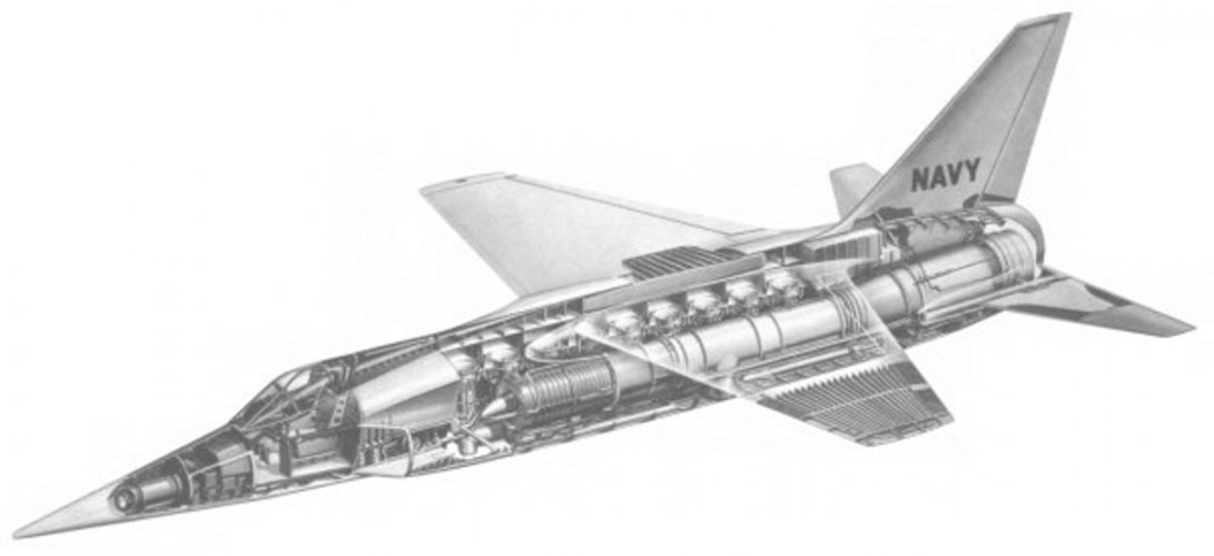

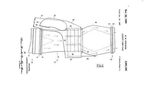

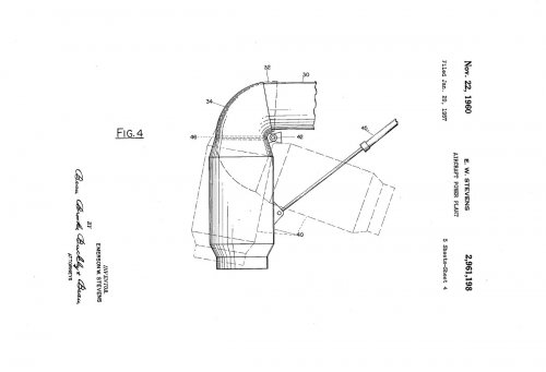

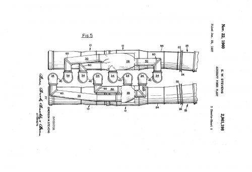

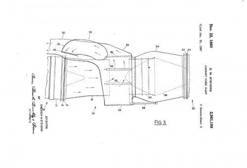

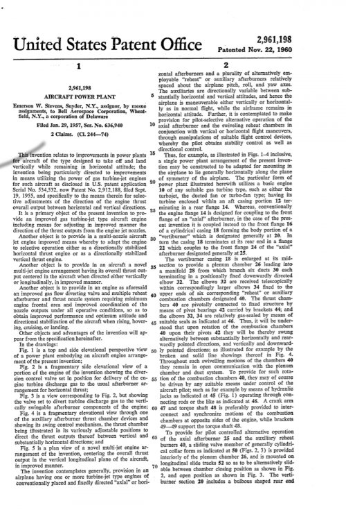

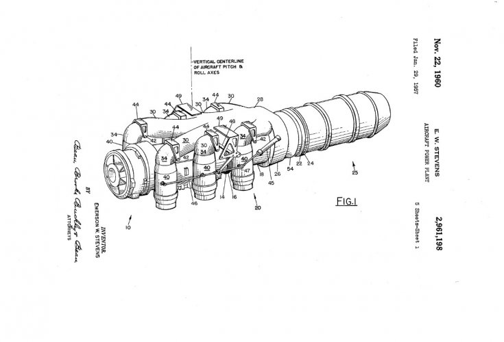

Hi! Vertiburner patent.
"In the drawings:
Fig. 1 is a top and side elevational perspective View of a power plant embodying an aircraft engine arrangement of the present invention;
Fig. 2 is a fragmentary side elevational view of a portion of the engine of the invention showing the diversion control valve set in position for delivery of the engine turbine discharge gas to the usual afterburner arrangement for horizontal thrust;
Fig. 3 is a view corresponding to Fig. 2, but showing the valve set to divert turbine discharge gas to the vertically swingable afterburner components of the engine;
Fig. 4 is a fragmentary elevational view through one of the auxiliary afterburner thrust chamber devices and showing its swing control mechanism, the thrust chamber being illustrated in its variously adjustable positions to direct the thrust outputs thereof between vertical and substantially horizontal directions; and
Fig. 5 is a plan view of a novel multi-jet engine arrangement of the invention, centering the overall thrust output in the vertical longitudinal plane of the aircraft, in improved manner.
Vertiburner applied design.

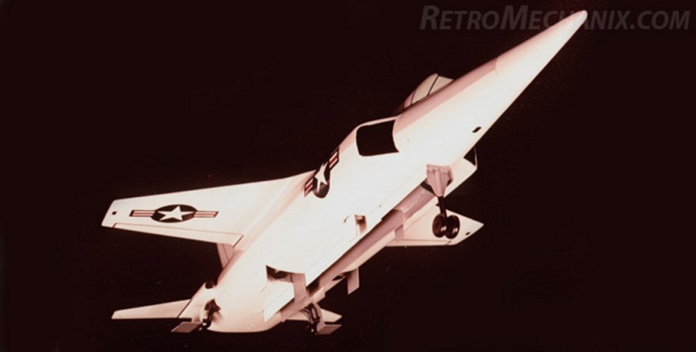

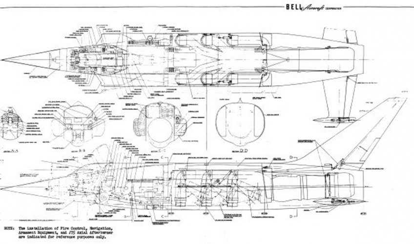

This design shows another concept. D-188? Fuselage main engine concept is same as D-188A.
D-188 main engine seems to be J79 and lift engine seems to be J85.
Perhaps Bell wanted to decrease D-188 lift engine dead weight by D-188A design.
Perhaps D-188 level flight engines are two J79s and VTOL engines are two J79s and nine J85s. Dead weight in level flight are nine J85s.
D-188A level flight engines are six J85s and VTOL engines are eight J85s. D-188A design does not need two J79 engines. Dead weight in level flight are only two J85s.
You can see nine lift engine exhaust nozzle long door at the center bottom of the fuselage and two main engine exhaust nozzle door at the side bottom middle of the fuselage when vertical flying mode in the second picture. Perhaps lift engines air intakes are located side of the fuselage, because if lift engines air intakes are located upper side of the fuselage, intake air push fuselage to downward same as XFV-12.
Aft landing gear and after burner air intake are located wing root of the horizontal tail stabilizer.
You can see nine lift engines located fuselage center line in bottom picture.

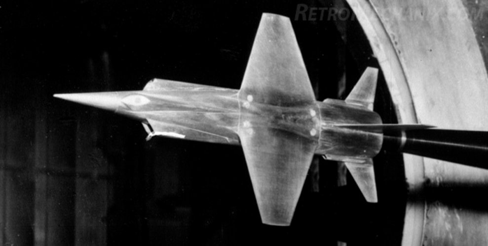

Re: Bell D,139 project

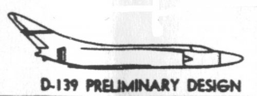

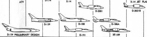

I believe this project is D-139 preliminary design which is included in Scott-san's chart.
Low wing, shock cone type air inlet, twin engine and tall vertical tail stabilizer with middle position horizontal tail stabilizer. Tailed double delta wing.
Fuselage bottom looks like space shuttle. Twin engine with vertiburner design?
Very rare picture!!

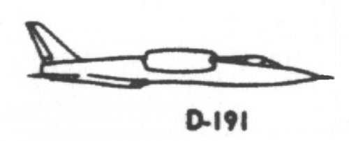

D-191 is a mysterious project. Any information?
D-139 preliminary design : two propulsion engines with vertiburners?
D-139 : one propulsion engine with six vertiburners
D-188 : two propulsion/lift engines+nine lift engines
D-188A : six propulsion/lift engines+two lift engines
Perhaps every propulsion engine have after burner.
