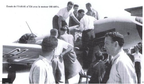

According to the IAR-80 TMA book, there were two airframes modified to take german DB engines( not counting the fact that the original IAR-80 project envisaged a Jumo-211 engine ).
First was IAR-80 no.13 modified in spring 1941 to take an DB-601Aa engine , only one unsuccesful flight made in april ( severe vibrations felt in the airframe , pilot ordered to jump , but he didnt and brought the aircraft for landing succesfully ).
Second was IAR-81C no.326 modified in 1943 to take a DB-605A engine , test flighted between june 20th and july 20th 1943 , aparently succesful , but for various reasons the envisaged modification of in-service aircraft to this configuration never happened ( imho what a pity ).

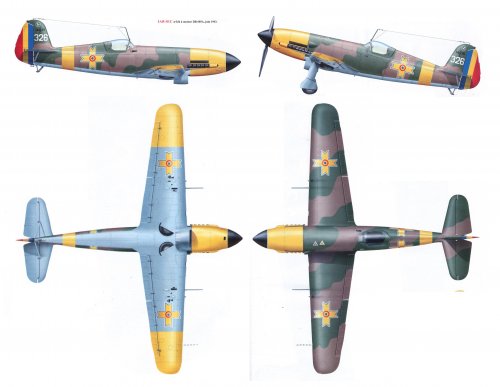

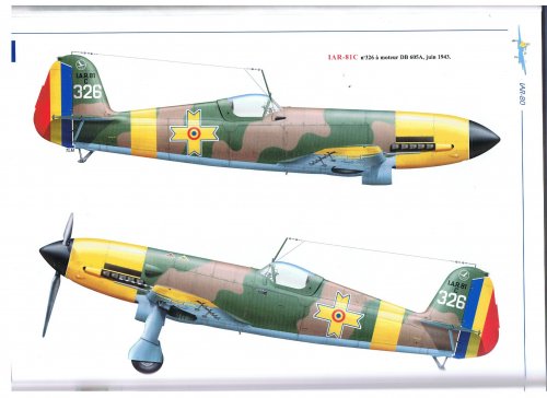

There's a jawdropping ( at least for me) color profile of this aircraft in the book , obviously based on the only picture of the inline IAR-80 available ( which it seems indeed shows no.326 in summer 1943).
I know it is a very very long shot , but i wonder if someone has more information on these aircrafts ? Photos ,drawings , performance datas , anything ? I posed the same question on romanian fora ( and hoping for something !) , and i thought maby there's a small chance someone abroad might have such "treasures" aswell...
Thanks for your time.
PS: Heres the color profile , all the copyright goes to the authors of the book and the drawings ,to be honest never knew exactly the ways of this copyright thingie ,what one can and cannot post , hope i'm not gonna thread on anyone's feet , not my intention...

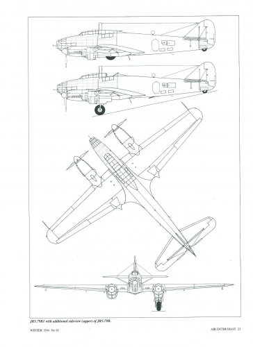

this, from 'On Three Fronts; Romania's Aircraft Industry During World War Two', 'Air Enthusiast' No.56, Winter 1994 page 15 :-
"...in early 1942, the Romanians experimentally fitted IAR-80a No 111 with one of the...Jumo 211Da engines...ordered for the JRS.79B (twin-engine variant of the Savoia-Machetti SM.79 bomber). Unfortunately the stresses set up by the original radial engine were very different to those of the new in-line engine, and on it's only flight the engine mounting worked loose, and the aircraft had make an unpowered emergency landing. Work was discontinued.

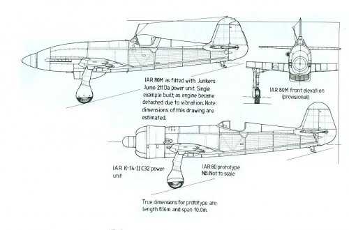

Some additional info here

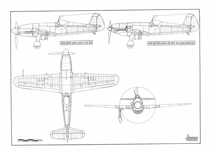

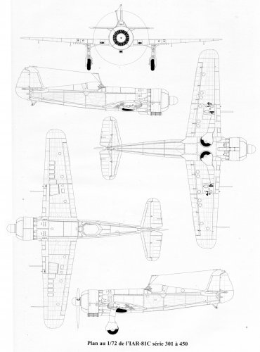

Same source, reduced to same scale of all views.
And IAR 81C as a basical aircraft.

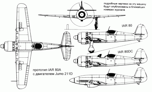

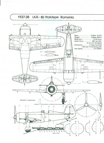

The IAR 80A inline version, along with the regular version and the 80DC (double cockpit) variant:
