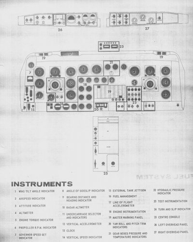

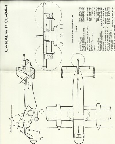

From the CL-84 brochure, revised edition February 1969, published by Canadair :

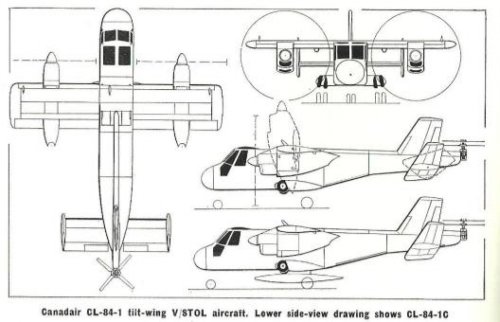

here is the early CL-84.

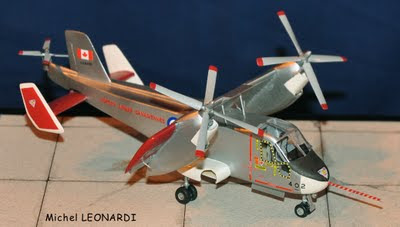

the kit is available now,
released....
http://www.sharkit.com/sharkit/canadair/canadair.htm

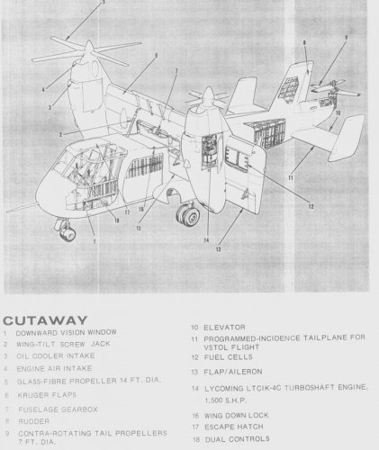

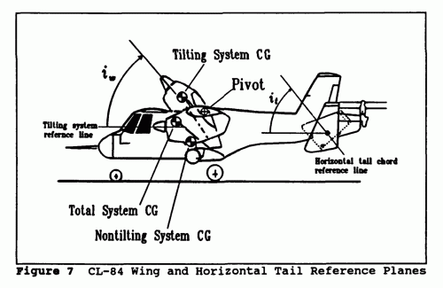

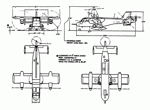

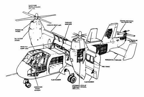

Different scan of the CL-84 cutaway and a couple more diagrams:
these picts were used for the kit design, about all of them.
This model have been released 2 years go or so,
Its about to be stocked out

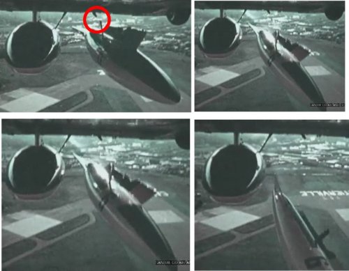

Interesting footage !

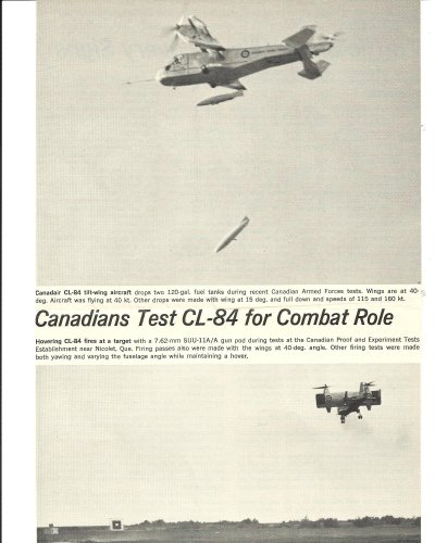

During the drop test, the tanks are noticeably veering inwards, when the first tank is dropped clearance
is relatively small, I think. Looks as if it is due to the strut (or whatever it is) disengaged after the main connection.

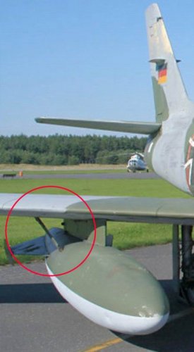

The tanks and struts are straight off the late production Canadair Sabres. I seem to recall that the strut came off late to induce a roll away from the centre line of the Sabre. It could have been a problem with a simultaneous tank release on the CL-84, probably a production solution would have been different.
The mixing of wing position, tail position, main prop pitch and tail rotor authority was all mechanical - done with bellcranks and levers. The design process resulted in several patents, and several heart attacks in the Canadair design office. The resulting aircraft was very complex, and prone to single point failures. One aircraft was lost when one prop jammed in pitch. If this aircraft had gone into production, I suspect its early years accident history would have been similar to the early years of the V-22.
Given the strut placement on both tanks, it looks to me like they wanted to make sure either tank did not contact the adjacent tank on release.
That probably was the intention, but as the footage shows, it nearly went wrong, as the tank, which was released at first comes
quite close to the other one. Maybe they sould have put the strut on the outer side, I thiink.
Yes, that is what I was trying to say several posts ago. The delayed strut detachment on the Sabre rolls the tank away from the fuselage. The tanks and struts and pylons were off-the-shelf, lying around at Canadair when adapted for the CL-84 prototypes. A production aircraft would have probably modified this.
